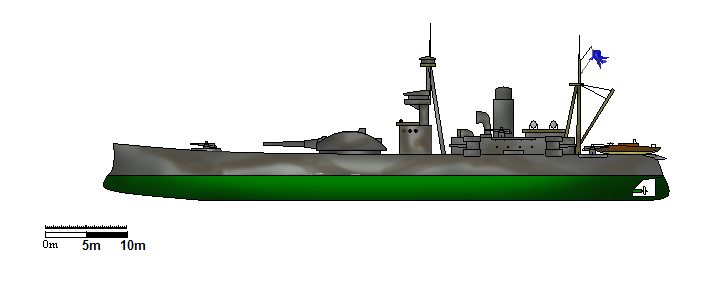

Gick tillbaka lite i historien och konstruerade denna "skonert" med torn.
Öland, Sweden Turretship of the line laid down 1864
Central citadel ship
Armoured Casemate Ship
Displacement:
6 090 t light; 6 463 t standard; 7 000 t normal; 7 430 t full load
Dimensions: Length overall / water x beam x draught
278,87 ft / 278,87 ft x 72,18 ft x 22,97 ft (normal load)
85,00 m / 85,00 m x 22,00 m x 7,00 m
Armament:
4 - 11,81" / 300 mm guns (2x2 guns), 502,53lbs / 227,94kg shells, 1864 Model
Muzzle loading guns in Coles/Ericsson turrets
on centreline, all amidships
20 - 4,72" / 120 mm guns in single mounts, 32,16lbs / 14,59kg shells, 1864 Model
Breech loading guns in broadside mounts
on side ends, evenly spread
Weight of broadside 2 653 lbs / 1 204 kg
Shells per gun, main battery: 150
Armour:
- Belts: Width (max) Length (avg) Height (avg)
Main: 9,84" / 250 mm 181,27 ft / 55,25 m 10,20 ft / 3,11 m
Ends: 3,94" / 100 mm 97,57 ft / 29,74 m 10,20 ft / 3,11 m
Upper: 3,94" / 100 mm 181,27 ft / 55,25 m 6,56 ft / 2,00 m
Main Belt covers 100 % of normal length
- Gun armour: Face (max) Other gunhouse (avg) Barbette/hoist (max)
Main: 7,87" / 200 mm 5,91" / 150 mm -
2nd: 3,94" / 100 mm 3,94" / 100 mm -
- Armour deck: 1,57" / 40 mm
Machinery:
Coal fired boilers, simple reciprocating steam engines,
Direct drive, 2 shafts, 1 982 ihp / 1 479 Kw = 11,00 kts
Range 2 600nm at 8,00 kts
Bunker at max displacement = 967 tons (100% coal)
Complement:
382 - 497
Cost:
£0,570 million / $2,282 million
Distribution of weights at normal displacement:
Armament: 332 tons, 4,7 %
Armour: 2 144 tons, 30,6 %
- Belts: 1 194 tons, 17,1 %
- Torpedo bulkhead: 0 tons, 0,0 %
- Armament: 549 tons, 7,8 %
- Armour Deck: 402 tons, 5,7 %
- Conning Tower: 0 tons, 0,0 %
Machinery: 562 tons, 8,0 %
Hull, fittings & equipment: 2 903 tons, 41,5 %
Fuel, ammunition & stores: 910 tons, 13,0 %
Miscellaneous weights: 150 tons, 2,1 %
Overall survivability and seakeeping ability:
Survivability (Non-critical penetrating hits needed to sink ship):
5 028 lbs / 2 281 Kg = 10,0 x 11,8 " / 300 mm shells or 1,3 torpedoes
Stability (Unstable if below 1.00): 1,28
Metacentric height 4,8 ft / 1,5 m
Roll period: 13,8 seconds
Steadiness - As gun platform (Average = 50 %): 76 %
- Recoil effect (Restricted arc if above 1.00): 0,12
Seaboat quality (Average = 1.00): 1,52
Hull form characteristics:
Hull has raised forecastle, raised quarterdeck
Block coefficient: 0,530
Length to Beam Ratio: 3,86 : 1
'Natural speed' for length: 16,70 kts
Power going to wave formation at top speed: 34 %
Trim (Max stability = 0, Max steadiness = 100): 50
Bow angle (Positive = bow angles forward): 0,00 degrees
Stern overhang: 0,00 ft / 0,00 m
Freeboard (% = measuring location as a percentage of overall length):
- Stem: 16,40 ft / 5,00 m
- Forecastle (20 %): 16,40 ft / 5,00 m (6,56 ft / 2,00 m aft of break)
- Mid (50 %): 6,56 ft / 2,00 m
- Quarterdeck (15 %): 16,40 ft / 5,00 m (6,56 ft / 2,00 m before break)
- Stern: 16,40 ft / 5,00 m
- Average freeboard: 10,01 ft / 3,05 m
Ship tends to be wet forward
Ship space, strength and comments:
Space - Hull below water (magazines/engines, low = better): 65,8 %
- Above water (accommodation/working, high = better): 45,1 %
Waterplane Area: 13 787 Square feet or 1 281 Square metres
Displacement factor (Displacement / loading): 115 %
Structure weight / hull surface area: 159 lbs/sq ft or 776 Kg/sq metre
Hull strength (Relative):
- Cross-sectional: 0,90
- Longitudinal: 2,69
- Overall: 1,00
Hull space for machinery, storage, compartmentation is excellent
Room for accommodation and workspaces is extremely poor
Ship has slow, easy roll, a good, steady gun platform
Excellent seaboat, comfortable, can fire her guns in the heaviest weather
Displacement:
Armament:
Armour:
Machinery:
Complement:
382 - 497
Cost:
- Overall: 1,00

Pojhanma, Sweden Monitor laid down 1898
Displacement:
2 942 t light; 3 137 t standard; 3 200 t normal; 3 250 t full load
246,06 ft / 246,06 ft x 59,06 ft x 9,84 ft (normal load)
75,00 m / 75,00 m x 18,00 m x 3,00 m
Armament:
2 - 10,83" / 275 mm guns (1x2 guns), 634,55lbs / 287,83kg shells, 1898 Model
Breech loading guns in a turret (on a barbette)
on centreline amidships
4 - 4,72" / 120 mm guns in single mounts, 52,72lbs / 23,91kg shells, 1898 Model
Breech loading guns in casemate mounts
on side, all aft
6 - 2,24" / 57,0 mm guns in single mounts, 5,65lbs / 2,56kg shells, 1898 Model
Quick firing guns in deck mounts
on side, evenly spread
6 - 0,79" / 20,0 mm guns in single mounts, 0,24lbs / 0,11kg shells, 1898 Model
on side, evenly spread, all raised mounts
Weight of broadside 1 515 lbs / 687 kg
Armour:
Main: 7,87" / 200 mm 117,45 ft / 35,80 m 9,22 ft / 2,81 m
Ends: 1,38" / 35 mm 86,09 ft / 26,24 m 9,22 ft / 2,81 m
42,52 ft / 12,96 m Unarmoured ends
Upper: 1,38" / 35 mm 159,94 ft / 48,75 m 6,56 ft / 2,00 m
Main Belt covers 73 % of normal length
Main: 7,87" / 200 mm 5,91" / 150 mm 7,87" / 200 mm
2nd: 1,77" / 45 mm 2,95" / 75 mm -
- Armour deck: 1,97" / 50 mm, Conning tower: 3,94" / 100 mm
Machinery:
Coal fired boilers, complex reciprocating steam engines,
Direct drive, 2 shafts, 1 614 ihp / 1 204 Kw = 12,00 kts
Range 1 000nm at 8,00 kts
Bunker at max displacement = 113 tons (100% coal)
Complement:
212 - 276
Cost:
£0,298 million / $1,193 million
Armament: 189 tons, 5,9 %
Armour: 1 216 tons, 38,0 %
- Belts: 554 tons, 17,3 %
- Armament: 188 tons, 5,9 %
- Armour Deck: 456 tons, 14,2 %
- Conning Tower: 18 tons, 0,6 %
Machinery: 258 tons, 8,1 %
Hull, fittings & equipment: 1 258 tons, 39,3 %
Fuel, ammunition & stores: 258 tons, 8,1 %
Miscellaneous weights: 20 tons, 0,6 %
4 648 lbs / 2 108 Kg = 7,3 x 10,8 " / 275 mm shells or 1,5 torpedoes
Stability (Unstable if below 1.00): 1,51
Metacentric height 4,6 ft / 1,4 m
Roll period: 11,6 seconds
Steadiness - As gun platform (Average = 50 %): 53 %
- Recoil effect (Restricted arc if above 1.00): 0,13
Seaboat quality (Average = 1.00): 0,97
Hull has a flush deck
Block coefficient: 0,783
Length to Beam Ratio: 4,17 : 1
'Natural speed' for length: 15,69 kts
Power going to wave formation at top speed: 41 %
Trim (Max stability = 0, Max steadiness = 100): 55
- Stem: 13,12 ft / 4,00 m
- Forecastle (20 %): 6,56 ft / 2,00 m
- Quarterdeck (15 %): 6,56 ft / 2,00 m
- Stern: 6,56 ft / 2,00 m
- Average freeboard: 7,09 ft / 2,16 m
Space - Hull below water (magazines/engines, low = better): 73,2 %
- Above water (accommodation/working, high = better): 73,8 %
Waterplane Area: 12 519 Square feet or 1 163 Square metres
Displacement factor (Displacement / loading): 98 %
Structure weight / hull surface area: 89 lbs/sq ft or 437 Kg/sq metre
- Cross-sectional: 0,97
- Longitudinal: 1,33
- Overall: 1,00
Room for accommodation and workspaces is cramped
Poor seaboat, wet and uncomfortable, reduced performance in heavy weather
- Bilagor
- pojhanma.jpg (52.03 KiB) Visad 1027 gånger
Japp 150ton är för riggen, wesworld går inte riktigt så långt bak men jag brukar höfta med 75ton per mast ungefär.Jag tilämpar "Wesworld" reeglerna så ofta jag kan även om inte slaviskt, de flesta är väl avvägda för att få realistiska konstruktioner som tex 50ton per sjöflygplan med katapult, eller så använder jag de riktiga vikterna.

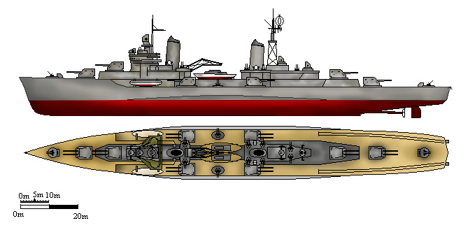

Här kommer dock mitt förlag till tung kryssare med tema återvinning! Håll till godo.
Swärdet, Swedish Heavy Cruser laid down 1940
Displacement:
12 432 t light; 12 697 t standard; 13 267 t normal; 13 723 t full load
601,30 ft / 590,55 ft x 65,62 ft x 24,61 ft (normal load)
183,28 m / 180,00 m x 20,00 m x 7,50 m
Armament:
6 - 10,00" / 254 mm guns (2x3 guns), 500,00lbs / 226,80kg shells, 1900 Model
Breech loading guns in turrets (on barbettes)
on centreline, all forward, 1 raised mount - superfiring
6 - 4,72" / 120 mm guns (3x2 guns), 52,72lbs / 23,92kg shells, 1940 Model
Dual purpose guns in deck mounts with hoists
on side, all amidships
2 - 4,72" / 120 mm guns (1x2 guns), 52,72lbs / 23,92kg shells, 1940 Model
on centreline aft, all raised guns - superfiring
12 - 1,57" / 40,0 mm guns (2x6 guns), 1,95lbs / 0,89kg shells, 1940 Model
Anti-aircraft guns in deck mounts
on centreline, on side, all raised mounts - superfiring
2 - 1,57" / 40,0 mm guns in single mounts, 1,95lbs / 0,89kg shells, 1940 Model
on centreline ends, evenly spread
Weight of broadside 3 449 lbs / 1 565 kg
6 - 21,0" / 533 mm above water torpedoes
Armour:
Main: 9,57" / 243 mm 311,68 ft / 95,00 m 9,48 ft / 2,89 m
Ends: 0,98" / 25 mm 200,92 ft / 61,24 m 9,48 ft / 2,89 m
77,95 ft / 23,76 m Unarmoured ends
Upper: 0,98" / 25 mm 311,68 ft / 95,00 m 8,01 ft / 2,44 m
Main Belt covers 81 % of normal length
Main: 9,57" / 243 mm 5,91" / 150 mm 9,57" / 243 mm
2nd: 0,98" / 25 mm 0,59" / 15 mm -
3rd: 0,98" / 25 mm 0,59" / 15 mm -
4th: 0,59" / 15 mm - -
5th: 0,59" / 15 mm - -
- Armour deck: 3,94" / 100 mm, Conning tower: 7,87" / 200 mm
Machinery:
Oil fired boilers, steam turbines,
Geared drive, 3 shafts, 83 866 shp / 62 564 Kw = 31,70 kts
Range 6 500nm at 12,00 kts
Bunker at max displacement = 1 026 tons
Complement:
617 - 803
Cost:
£6,667 million / $26,669 million
Armament: 431 tons, 3,2 %
Armour: 4 269 tons, 32,2 %
- Belts: 1 408 tons, 10,6 %
- Armament: 833 tons, 6,3 %
- Armour Deck: 1 932 tons, 14,6 %
- Conning Tower: 95 tons, 0,7 %
Machinery: 2 242 tons, 16,9 %
Hull, fittings & equipment: 5 490 tons, 41,4 %
Fuel, ammunition & stores: 835 tons, 6,3 %
Miscellaneous weights: 0 tons, 0,0 %
18 052 lbs / 8 188 Kg = 36,1 x 10,0 " / 254 mm shells or 2,3 torpedoes
Stability (Unstable if below 1.00): 1,00
Metacentric height 2,7 ft / 0,8 m
Roll period: 16,9 seconds
Steadiness - As gun platform (Average = 50 %): 52 %
- Recoil effect (Restricted arc if above 1.00): 0,73
Seaboat quality (Average = 1.00): 1,00
and transom stern
Block coefficient: 0,487
Length to Beam Ratio: 9,00 : 1
'Natural speed' for length: 28,01 kts
Power going to wave formation at top speed: 57 %
Trim (Max stability = 0, Max steadiness = 100): 52
Bow angle (Positive = bow angles forward): 20,00 degrees
- Stem: 29,53 ft / 9,00 m
- Forecastle (20 %): 19,69 ft / 6,00 m
- Mid (50 %): 19,69 ft / 6,00 m
- Quarterdeck (15 %): 19,69 ft / 6,00 m
- Average freeboard: 20,23 ft / 6,17 m
Space - Hull below water (magazines/engines, low = better): 78,2 %
- Above water (accommodation/working, high = better): 144,0 %
Waterplane Area: 26 528 Square feet or 2 465 Square metres
Displacement factor (Displacement / loading): 109 %
Structure weight / hull surface area: 131 lbs/sq ft or 639 Kg/sq metre
- Cross-sectional: 0,94
- Longitudinal: 1,76
- Overall: 1,00
Room for accommodation and workspaces is excellent
Main guns taken from scraped Oden class, modernised and in new turrets. Main armour belt also taken from Oden class. This due to forced production during wartime consturction. This reduces the building time and price.
// Stofilen
Frågan är om man måste höja utgångshastigheten för att få tillräcklig räckvidd? Hur långt kommer man med ökad elevation och med modernare arodynamisk utformning av projektilerna. På Fylgia ökades räckvidden från cirka 12km till 16km vid moderniseringen 1941. Jag vet dock inte exakt vad den moderniseringen omfattade.
Givetvis är det bättre med nyproducerade men, tanken med att använda gamla pjäser är att bofors skulle vara för upptaget under kriget för att kunna leverera pjäser till fler fartytg. Jag utgår från att året är 1939-40 och att sverige ska ta fram ett tungt fartyg så snabbt det bara är möjligt.
Aj aj du är inte nådig mot gammla sverigeklassen! Jag tycker att man bör behålla dom för att det var dom enda fartyg som eventuella fiender som Tyskland och Sovjet respekterade. Utan dom hade vi inte några tunga fartyg alls. Med andra ord bättre kassa sverige klassen under hela kriget än nya moderna fartyg som blir färdiga tidigast 1944.
Displacement:
Armament:
Armour:
Machinery:
Complement:
617 - 803
Cost:
and transom stern
- Overall: 1,00
// Stofilen

Miscellaneous weights: 25 tons, 0,3 %
9 123 lbs / 4 138 Kg = 13,2 x 11,1 " / 283 mm shells or 2,0 torpedoes
Stability (Unstable if below 1.00): 1,09
Metacentric height 2,8 ft / 0,9 m
Roll period: 16,8 seconds
Steadiness - As gun platform (Average = 50 %): 70 %
- Recoil effect (Restricted arc if above 1.00): 0,67
Seaboat quality (Average = 1.00): 1,48
Block coefficient: 0,488
Length to Beam Ratio: 5,91 : 1
'Natural speed' for length: 19,92 kts
Power going to wave formation at top speed: 46 %
Trim (Max stability = 0, Max steadiness = 100): 47
Bow angle (Positive = bow angles forward): 4,75 degrees
Stern overhang: 0,66 ft / 0,20 m
- Stem: 19,69 ft / 6,00 m
- Forecastle (18 %): 18,04 ft / 5,50 m (15,58 ft / 4,75 m aft of break)
- Mid (50 %): 11,81 ft / 3,60 m
- Quarterdeck (18 %): 12,80 ft / 3,90 m
- Stern: 13,94 ft / 4,25 m
- Average freeboard: 14,11 ft / 4,30 m
Space - Hull below water (magazines/engines, low = better): 77,0 %
- Above water (accommodation/working, high = better): 97,4 %
Waterplane Area: 15 979 Square feet or 1 485 Square metres
Displacement factor (Displacement / loading): 96 %
Structure weight / hull surface area: 136 lbs/sq ft or 662 Kg/sq metre
- Cross-sectional: 0,91
- Longitudinal: 2,15
- Overall: 1,00
Room for accommodation and workspaces is adequate
Good seaboat, rides out heavy weather easily
